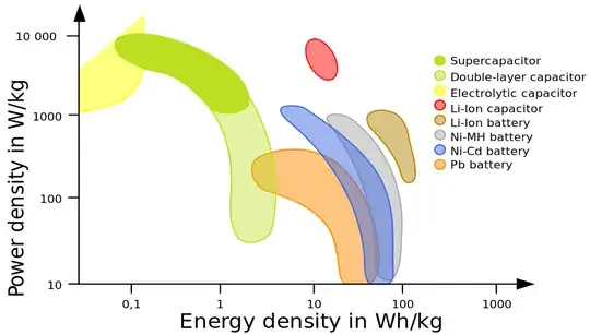

For example, in the below plot:
$ {\require{color}} {\definecolor{capacitor}{RGB}{255,10,10}} {\definecolor{lightCapacitor}{RGB}{255,131,131}} {\definecolor{battery}{RGB}{186,138,20}} {\definecolor{lightBattery}{RGB}{219,194,133}} % %\text{For example, in the below plot:} \\ \hskip{1em} \lower{2.5ex}{ \begin{array}{l} {\rlap{\color{capacitor}{\rule{15px}{15px}}}} {\rlap{\raise{4px}{\hskip{4px} \color{lightCapacitor}{\rule{7px}{7px}}}}} \hskip{21px} {\raise{2px}{ {\color{capacitor}{\textbf{Li-ion capacitor}}} ~\text{has a higher discharge rate; though} }} \\ {\rlap{\color{battery}{\rule{15px}{15px}}}} {\rlap{\raise{4px}{\hskip{4px} \color{lightBattery}{\rule{7px}{7px}}}}} \hskip{21px} {\raise{2px}{{\color{battery}{\textbf{Li-ion battery}}} ~\text{can store more energy.}}} \end{array} } $
$\hskip{50px}$$ {\require{cancel}} {\def\place#1#2#3{\smash{\rlap{\hskip{#1px}\raise{#2px}{#3}}}}} \place{305}{219}{\color{capacitor}{\bcancel{\phantom{\rule{97px}{25px}}}}} \place{377}{191}{\color{battery}{\cancel{\phantom{\rule{25px}{7px}}}}} $
Note that power has units of $\left[\frac{\text{energy}}{\text{time}}\right]$. This is, power is the rate at which energy's delivered.
Conceptually, there seems to be a conflict-of-interest between storing energy and being able to rapidly lose it (i.e., deliver power). As shown above, particular technologies tend to have a trade-off between their ability to store and deliver energy.
