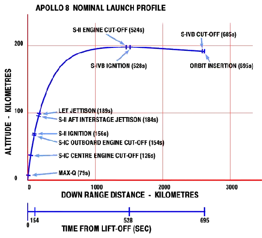

On launch the rocket spends the initial portion of flight attempting to gain altitude to go into the upper atmosphere where the air is less dense. Then it switches into a lateral velocity regime to gain the necessary lateral velocity to obtain orbit. The rocket profile is attempting to minimize drag as it is a waste of fuel. Less drag = less heating.
Look at the launch profile below. You see the initial moments of the launch the rocket does not move downrange much, relative to its altitude. It is in the later portions of flight that it begins to travel laterally once it has punched out of the dense, lower portion of the atmosphere. You can even see that the maximum aerodynamic forces, Max-Q (drag), are experienced very low in the atmosphere, mostly because of the density of the air.
launch profile

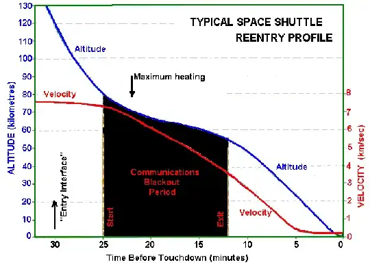

On reentry the flight profile is optimized to experience increased drag while maintaining a survivable level of deceleration and thermal load. They do this because the vehicle needs to shed orbital velocity (on the order of 16,000 mph) and the cheapest way to do this is to let atmospheric drag slow you down. The technique is called aerobraking. Because they have designed the flight profile to generate increased drag (as compared to launch) and because the velocity with which it penetrates the atmosphere, it experiences much greater heat build up than on launch. More drag, more speed = more heating.
The generated heat simply comes from the conservation of energy. The vehicle's velocity is shed as heat via ablation (of the reentry shield), adiabatic air compression, and other effects. The kinetic energy of the vehicle is transformed into thermal energy, resulting in the loss of velocity. Just like in your car, when it comes to a stop, the brakes will have become very hot because they have converted the KE of the vehicle into thermal energy.
Now look at the reentry profiles below. You notice that they have a near level part in the middle. That is where the aerobraking maneuver is performed.
reentry profile
If they did not use aerobraking, then the vehicle would have to carry enough rocket fuel to fire against the direction of motion until the relative velocity was sufficiently slow to come down without heating and/or vehicle disintegration. So this method of landing, without aerobraking is possible (its how we land on airless moons), but extremely inefficient.
