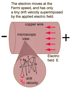

This is a microscopic view of the current:
microcurrent

When a microscopic view of Ohm's law is taken, it is found to depend upon the fact that the drift velocity of charges through the material is proportional to the electric field in the conductor. The ratio of voltage to current is called the resistance,
A microscopic view of Ohm's law
ohmsmicro
Why don't they keep flowing past the lamp and drain the battery, just like a short circuit? Why does the resistance dictate the current?
They will eventually drain the battery, but after some time much longer than the short circuit time because the current depends on the resistance which depends on the collisions the electrons have in the material, the larger the number of random collision the larger the resistance, as seen in the links given.
Electrons in conductors are like students running through an empty corridor when the class is let out, or running into a crowd of students partially blocking the way and slowing the flow.
