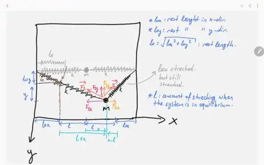

We have 2 spring 1 mass system in 2D as shown,
System
Here is my brief attempt of solution: $$\vec{F_x} = \vec{F_{1x}} + \vec{F_{2x}}= -k (x + l) \hat{\imath}- k (x-l)\hat{\imath} = -2 k x \hat{\imath} \quad \Rightarrow \quad \ddot{x}+\frac{2k}{m}x=0,$$ $$\vec{F_y} = \vec{F_{1y}} + \vec{F_{2y}}= -2 k y \hat{\jmath} \quad \Rightarrow \quad \ddot{y}+\frac{2k}{m}y=0.$$ General solution for these equations are; $$x(t) = A \sin(\omega t) + B\cos(\omega t),$$ $$y(t) = C \sin(\omega t) + D\cos(\omega t),$$ where $\omega = \sqrt{\frac{2k}{m}}$. Evaluating the initial conditions as follows; $$x(0) = x_0 \quad \Rightarrow \quad x(0) = A \sin(0) + B\cos(0) = B = x_0,$$ $$y(0) = y_0 \quad \Rightarrow \quad y(0) = C \sin(0) + D\cos(0) = D = y_0,$$ $$\dot{x}(0) = V_{0x} = 0 \quad \Rightarrow \quad \dot{x}(0) = A \omega \cos(0) - x_0\omega\sin(0) = A = 0,$$ $$\dot{y}(0) = V_{0y} = 0 \quad \Rightarrow \quad \dot{y}(0) = C \omega \cos(0) - y_0\omega\sin(0) = C = 0,$$ $$\therefore x(t)=x_0\cos(\omega t), \quad y(t)=y_0\cos(\omega t).$$ I've checked this solution with another method given here in the first answer and they are consistent. Notice there is a little error in the last equation, it should be $m$ instead of $2m$; you may crosscheck here in the first answer.

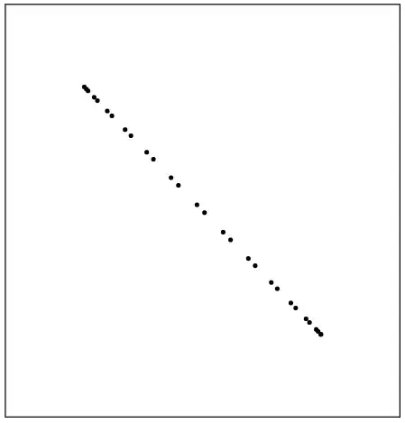

I made a figure of this solution and here it is:

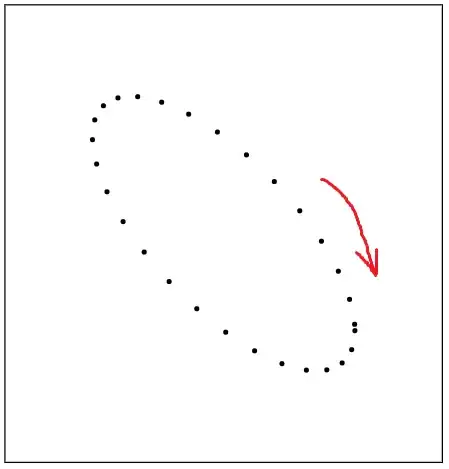

In faculty, we've performed this experiment and the result looks like something like this (also made by me):
The dots show the position of the mass. The only difference between these two pictures is the phase shift. To obtain the experimental figure I add a phase shift of to $y(t)$ and; $$y(t) = y_0\cos(\omega t + \phi),\quad\phi = \arctan(y_0 / x_0).$$
And also there is this: When we performed this experiment in lab, the instructor said that the $x(t)$ and $y(t)$ should have a phase shift of $\pi/2$, wrt eachother, meaning if $x(t)\sim\cos(\omega t)$ then $y\sim\sin(\omega t)$ and vice versa. And this was the actual case in the lab.

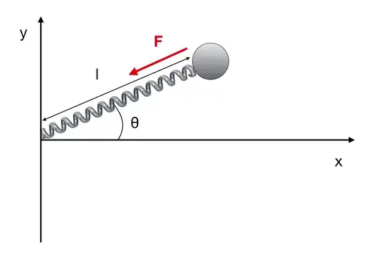

Your equations of motions are wrong. To understand why, consider the case in this picture:
What are the $x$ and $y$ components of the force $\mathbf F$ acting on the mass?
If the rest length of the spring is $l_0$ and its elastic constant is $k$, the force $\mathbf F$ is
$$\mathbf F = k \hat r (l - l_0) = k \hat r \left( \sqrt{x^2+y^2}-l_0\right)$$
where $\hat r$ acts in the direction of the red arrow, i.e. $\hat r = (-\cos \theta, -\sin \theta)$. The $x$ and $y$ components are therefore
$$F_x = -k \cos \theta \left( \sqrt{x^2+y^2}-l_0\right) \\F_y= -k \sin \theta \left(\sqrt{x^2+y^2}-l_0\right)$$
where
$$\theta = \arctan \left( \frac y x \right)$$
If we were to follow a method similar to yours, we would obtain
$$F_x = -k (x-l_0)\\ F_y = -k y$$
Which is wrong and corresponds to the case of two independent springs with identical constants acting on the mass.

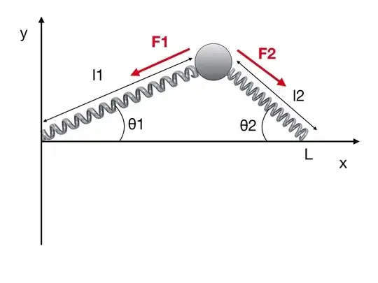

Let's take the case with two identical springs:
Based on the previous analysis, you can easily see that
$$\mathbf F_1 = k \hat r_1 \left( \sqrt{x^2+y^2}-l_0 \right) \\\mathbf F_2 = k \hat r_2 \left( \sqrt{(x-L)^2+y^2}-l_0 \right)$$
where $\hat r_1 = (-\cos \theta_1, -\sin \theta_1)$ and $\hat r_2 = (\cos \theta_2, -\sin \theta_2)$. It follows that the $x,y$ components are
$$F_x = -k \cos \theta_1 \left( \sqrt{x^2+y^2}-l_0 \right) + k \cos \theta_2 \left( \sqrt{(x-L)^2+y^2}-l_0 \right) \\F_y = -k \sin \theta_1 \left( \sqrt{x^2+y^2}-l_0 \right) - k \sin \theta_2 \left( \sqrt{(x-L)^2+y^2}-l_0 \right)$$
where
$$\theta_1 = \arctan \left(\frac y x \right) \\ \theta_2=\arctan \left(\frac {L-x} y \right)$$
The equations of motions are therefore quite complicated to solve exactly. If you can code, I would suggest to solve them with some integrator like Velocity Verlet.

The calculation of the stiffness in $y$ direction is incorrect. The stiffness in $y$-direction does not depend on the spring stiffness $k$, but only on the tension force $T$ in the springs, and the length of the springs in rest (as attached to the mass).
The stiffness in $y$-direction is given by:
$$F = T \sin\theta = T ~\frac{y}{L}$$
Where $\theta$ is the angle between the spring and the X-axes. Note that the last '=' sign is only valid for small displacements, but so is the whole analysis. If $\theta$ increases, the effect of $T$ decreases with $\cos \theta$, and the effect of the spring stiffness increases with $\sin \theta$.
There normally is no phase-shift, because the frequencies in $x$ and $y$ directions are different. They can only match for certain values of $k$, length $L$ of spring and $T$. If they match, the shift can be determined with the initial conditions, like you did.

If the springs are in tension $T$ at equilibrium, and the amplitudes are small, then the restoring forces are $F_x \approx -2kx$ and $F_y \approx -2\frac{T}{L}y$, where $L$ is the stretched length of the spring, as explained in Understanding transverse oscillation in 1 mass, 2 spring systems. If the natural length of the springs is $L_0$ then $T=k(L-L_0)$ so $F_y \approx -2k(1-\frac{L_0}{L})$. The oscillations in the $x$ and $y$ directions are approx. linear and independent, so they are simple harmonic, but the frequencies differ in the ratio $f_y/f_x \approx \sqrt{1-\frac{L_0}{L}}$.
This difference in frequency means that the phase difference between the $x$ and $y$ oscillations gradually increases. The motion is not like either of your graphs, which show a constant phase difference. Instead the motion cycles from a linear oscillation as in graph 1 to an elliptical oscillation in graph 2 which becomes circular. It then becomes elliptical again, but this time with the line (=axis of the ellipse) reflected in the y axis. After becoming linear again the direction of the oscillation then reverses and the cycle begins again. This motion is illustrated by an animation in Why is the vibration in my wire acting so oddly? and can be seen in your video also.

The equation which you derived for $F_y$ only applies when $L \gg L_0$. Then $f_y/f_x \approx 1$ so the phase difference remains approx. constant. If you start the system from rest, the phase difference is zero (graph 1) because both $x$ and $y$ start at maximum displacement so they have the same phase. The amplitudes do not have to be the same, because frequency is independent of amplitude. To have a constant phase difference as in graph 2 you can push the mass in the $x$ or $y$ direction as you release it.
