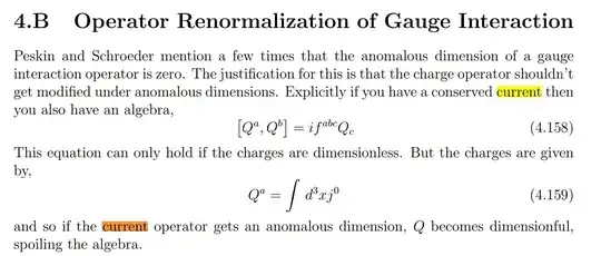

Among the local operators of the theory, special role will be played by a stress tensor $T_{\mu\nu}$ and conserved currents $J_{\mu}$ associated to global symmetries of a theory. QFT axioms (Wightman axioms) don’t require existence of the stress tensor as the energy and momentum density, but only of full energy and momentum charges, and analogously for the conserved currents. Thus the existence of the stress tensor and currents is an extra assumption. It means that the theory preserves some locality. In perturbation theory these two operators don’t renormalize, i.e, have zero anomalous dimensions: $$\gamma_T = \gamma_J = 0$$
Simple argument:
