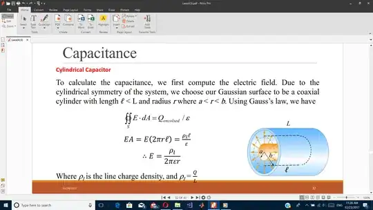

However in any other geometry such as a cylindrical geometry, we use the field due to one plate only. For instance, the following:
Capacitance inside a Cylinder
The E field is identical to that of only one plate, not the addition of the positive and negative plates fields. Why is this the case?
We do take into account the field due to both plates in the cylindrical geometry. The field due to an infinite uniformly charged cylinder is zero in the interior of the cylinder, as can be shown by symmetry arguments combined with Gauss's Law.
