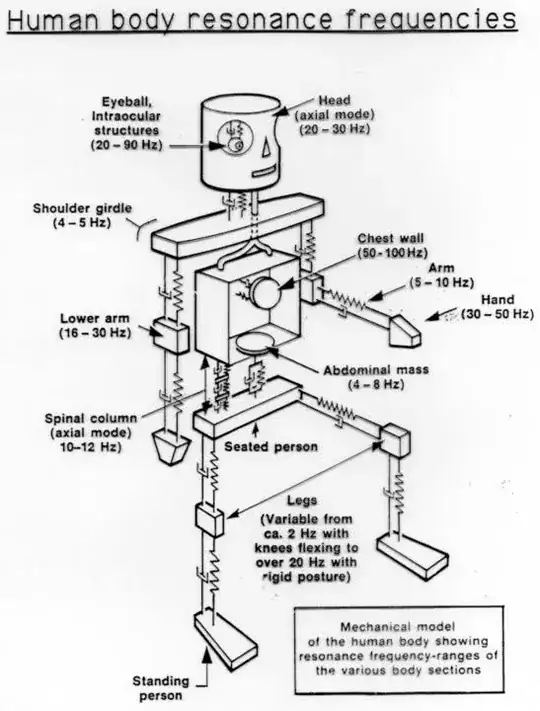

There seem to be a lot of human body mechanical models, such as this one: enter image description here
As for applications, I have heard that sub-audio frequency vibrations have been considered as nonlethal weapons for riot control.
Addendum:
Guys, stop upvoting this. The image was not composed by me. I found it so long ago there's no chance to find the original source. Google reverse image search says it might be newbedev.com. In the "related images" section there are other similar interesting sketches on human resonant frequency.
