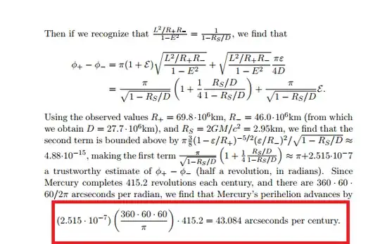

(1)(page 9 in the paper)
As you can see there are two terms in the final equation. But when they plugged in the observational values. they only took $2.515*10^7$ but did not use $4.88*10^{-15}$ . WHY?

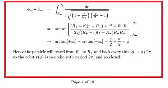

(2)(Page 4) I tried to calculate this integration on Mathematica.But gives different result.

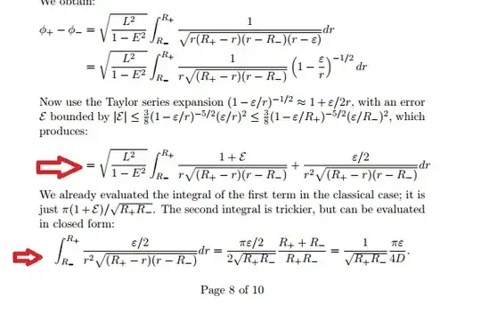

(3)(page 8)I did not get the how the Taylor series expansion led to the equation which is marked in red arrow (1st arrow). also the integration which is marked in red arrow.(2nd arrow). enter image description here

As far as I can tell from the text, $4.88 \times 10^{-15}$ is the upper bound on the second term in the equation for $\phi_+ - \phi_-$. This is a very small number, meaning the first term alone, $2.515 \times 10^{-7}$, is a good approximation for the equation, and hence the value of $\phi_+ - \phi_-$ as a whole.
In the case of the first arrow, simply replace $1- \left( \frac{\epsilon}{r} \right)^{-1/2}$ with $1+\epsilon/2r$ in the integration.
In the case of the second arrow, integrate the second term between $R_+$ and $R_-$ with respect to $r$.
