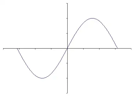

Suppose we write the equation of motion as:
$$ y = A \sin(\omega t) = A \sin\left(\frac{2\pi}{T} t \right) $$
If the period $T$ is a positive number then the variation of $y$ with time looks like this:
Positive T

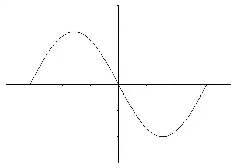

If we keep the magnitude of $T$ the same but make it a negative number then we get this:
Negative T
which is the same graph just shifted along the time axis by $\pi$. So yes you can make $T$ negative if you wish. The initial conditions will determine which is correct i.e. is the velocity positive or negative when $t=0$?
Having said this, we wouldn't normally talk about a negative period. If we wanted the second graph we'd probably keep $T$ as a positive number and write the equation with a phase shift i.e.
$$ y = A \sin\left(\frac{2\pi}{T} t + \pi \right) $$
