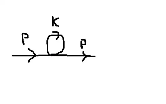

Consider the Feynman diagram below: enter image description here
in the case of $\phi^4$ theory where there is no bare mass: $$\mathcal{L}=\frac{1}{2} \partial_\mu \phi\partial^\mu\phi-\frac{\lambda}{4!} \phi^4$$ the contribution of this diagram is given by: $$I=\frac{-i\lambda}{2} \int \frac{d^d k}{(2\pi)^d}\frac{1}{k^2+i\varepsilon}$$ typically such integrals are done using Feynman and Schwinger Parameterizations. In this case, however Schwinger parameterization won't work as you will have a completely imaginary exponential. It also appears to be the case that $$\lim_{m\rightarrow 0}\frac{-i\lambda}{2} \int \frac{d^d k}{(2\pi)^d}\frac{1}{k^2-m^2+i\varepsilon}$$ which can be done using Schwinger parameterization does not converge onto the same value as $I$. Thus my question is: what is the most common way to deal with integrals of the form $I$ in QFT ideally using minimal subtraction.
In dimensional regularization, loop integrals which do not depend on physical external momenta are automatically regularized to be zero. This is so because, in absence of a mass scale, the integral is both UV and IR divergent and the divergences are regulated to zero.
Then, in dimensional regularization, you can regulate any integral of this sort
$$ I_a =\int d^d k\, k^a = 0 $$
for any value of $a$. You can see this result is really obvious since the mass dimension of $I_a$ is $[I_a] = d+a$ but since you don't have any mass scale in the problem, what dimensionful result different from zero would you expect?
