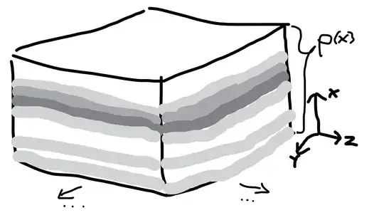

EDIT: For clarity, the one-dimensional Poisson equation you write in the question, $$ \frac{\mathrm d^2V}{\mathrm dx^2} = \frac{\rho(x)}{\epsilon_0} $$ is only valid for situations of the following form,
enter image description here if you'll forgive the hastily-drawn diagram, i.e. three-dimensional situations where there is complete translational equivalence on the $y$ and $z$ dimensions, and the charge density only depends on the $x$ coordinate. It should be clear that in this situation the source is a volumetric charge distribution, with a volumetric charge density $\rho(x)$, which eliminates the dimensionality problem in your question.
(This requires an infinite domain, which is obviously not physical, so you just consider domains which are large enough that edge effects are negligible, and you impose on the solutions of the Poisson equation the additional condition that they share the 2D translational invariance of the source. Infinite-span bulk charge densities can indeed get you into trouble, but asking for translational invariance, when done correctly, tends to work fine.)
