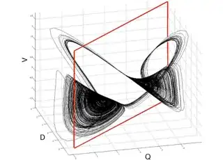

That's precisely what, e.g., Gissinger proposes in A new deterministic model for chaotic reversals (arxiv):
currently travelling about 64Km per year, but that seems small and also quite regular, not what you would expect to be the result of a chaotic system
As the picture above suggests, even if the times when the curve (trajectory) changes from one roll to the other are unpredictable, the overall movement, especially between changes is very smooth and approximately regular. It's a similar situation to the Solar system, which is chaotic, but whose short-time behavior is mostly pretty predictable.
