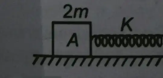

Suppose the above system moves with a velocity $v$ and collides into a wall.
The spring compresses and stores the energy, so energy is conserved.
However during the collision the spring compresses.
How is momentum conserved as during the compression the speed of the block reduces?
Momentum is conserved at all times, including during the collision. The apparent violation of conservation of momentum is because the mathematical “wall” has an infinite mass.
Try replacing the wall with a large mass, maybe 100m, and see what happens. Now make it 1000x bigger. And so on. As it gets more massive it has less velocity after the impact but it always has the same momentum, and momentum of the system will always be conserved. The limit as the mass of the wall approaches infinity is a post-collision velocity of zero.
