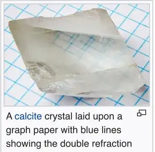

Photons are not moving up and down. Photons are traveling straight forwards as long as they don’t get influenced by magnetic or electric fields in a very specific way. See birefringence:
So the two definitions of a wave for mechanical waves and in electromagnetism is very different and the analogy in EM is due to the oscillation of the electric and the magnetic field components
