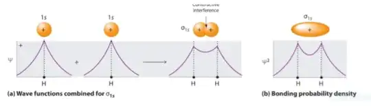

It probably helps to define what a covalent bond really is. Covalent bonds occur when one or more Atomic Orbitals (AO) of the participating atoms constructively interact and form a (bonding) Molecular Orbital (MO). The figure below schematises the formation of a $\sigma_{ss}$ MO when two hydrogen atoms combine to form a dihydrogen molecule:
Sigma orbital
The $+$ signs indicate the wave functions of the $1s$ orbitals of both atoms have the same sign (phase) (two atoms with opposing phases form an anti-bonding MO, not pictured here). The resulting $\sigma_{ss}$ MO is approximately a linear combination of the individual wave functions. Again, schematically:
$$\psi_{1s,1}+\psi_{1s,2}\to \psi_{\sigma}$$
The MO, in accordance with Pauli, always 'contains' $2$ electrons of opposite spin. So the MO can be said to be 'full'.
To the right is also schematised the electron probability density $\psi^2$ and note that this density is very significant on the nuclear axis, between both nuclei. This causes the intra-nuclear Coulombic repulsion force to greatly reduce and the molecular arrangement to be stable, meaning that pulling it apart would cost energy. This energy is often referred to as the bond strength (in $\mathrm{kJ/mole}$).
$\sigma$ MOs can also arise between different types of AOs, like $\sigma_{sp}$ and $\sigma_{pp}$ MOs. And between $p$ and $p$ AOs, so-called $\pi$ MOs can form. These are needed to form the stronger double bonds and the even stronger triple bonds.
