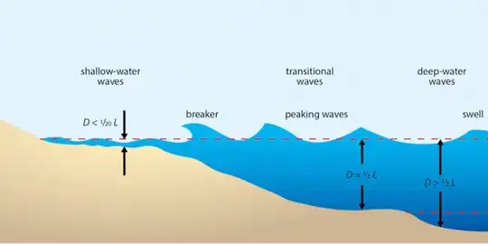

A wave with a height of 2 m and a wavelength of 14 m breaking along 2 km of coastline (surface area = 32,000 m2) has approximately 45 kWh of energy.
How it will be dissipated will depend on the approach to the coast.
A wave as seen above will start losing energy by transferring it to kinetic and rotational energy at the shallow bottom including sand transfers, which finally will become heat (extra kinetic energy). As there will be conservation of momentum also, part of it will be absorbed by the impact on the earth, as vibrations which will also end up as heat, and also any dissipation in air as you observe. In the picture above sand will be continually deposited on the shore changing the shore line.
A wave hitting a rocky precipice will be transferring vibrations (finally heat) but also will erode part of the rock.
In the end all energy will end up as a higher temperature in the region and ground than if the ocean were calm.
