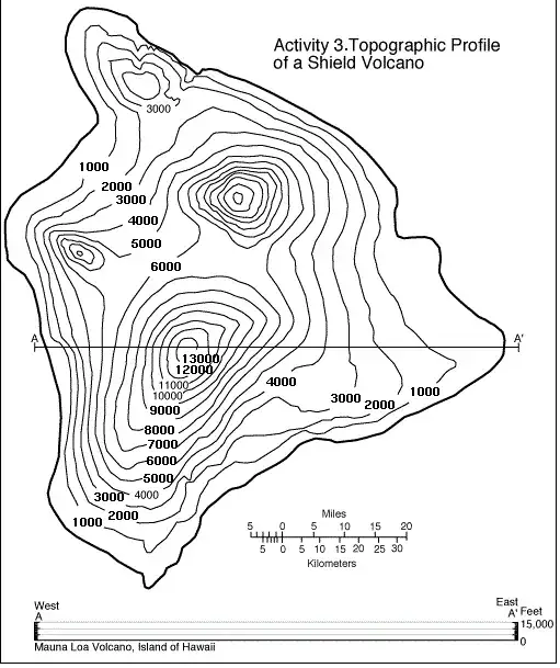

Consider a hiker who wants to plan his ascent up Mauna Loa in Hawaii. After making some assumptions, such as the assumption that the mountain's surface -- a 2-dimensional surface embedded in a 3-dimensional space -- is relatively smooth and features like vertical cliffs or overhangs can be neglected, he can construct a continuous scalar function $h(x,y): D \subseteq \mathbb{R}^2 \to \mathbb{R}$ that takes in a coordinate pair $(x,y)$ and outputs the height of the mountain $h$ at that coordinate. Once he has this function, he can determine a set of coordinate pairs that satisfy the condition $h(x,y) = k$ for some constant $k$ and depict that set of points in $\mathbb{R}^2$. After doing this for several different values of $k$, the picture he ends up with looks something like this:
Topographic Map of Mauna Loa
This is a topographic map of Mauna Loa, and the curves seen on the map, each of which are constructed from the set of coordinate pairs that satisfy the condition $h(x,y) = k$ for some constant $k$ (the $k$ values are written on the curves), are known as contour curves. The gradient $\nabla h(x,y)$ is defined so that at any given point $(x_0,y_0)$, $\nabla h(x_0,y_0)$ will point both in the direction locally perpendicular to the contour curve that $(x_0,y_0)$ falls on and also in the direction of locally increasing altitude. With this information, he can plan his ascent up the mountain.
While $\nabla h(x,y)$ is a vector field in $\mathbb{R}^2$, forces in Newtonian mechanics are in general described by vector fields in $\mathbb{R}^3$. The drawback of a conservative vector field $\mathbf{v}$ in $\mathbb{R}^3$ is that the scalar potential $\varphi$ associated with $\mathbf{v}$ is more fully depicted as a 3-dimensional surface embedded in a 4-dimensional space -- a geometric depiction we cannot easily visualize. However, just as the hiker constructed contour curves in $\mathbb{R}^2$ to visualize the mountain, we can similarly construct equipotential surfaces for a scalar potential $\varphi(x,y,z)$ to depict it in $\mathbb{R}^3$ using the same method.
