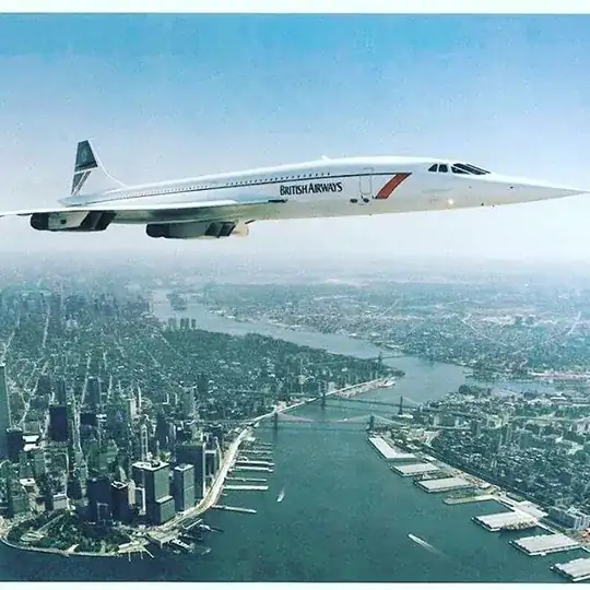

I was having a discussion with a friend about supersonic flights.
Concord
