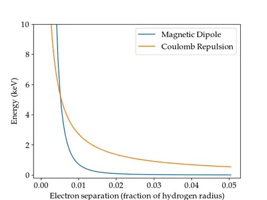

Edit: I made a plot for my paper showing the dipole and coulomb energies calculated by classical E&M, and I'll share it for those who don't know how to do the calculation.
The plot I made
The dipole dies off at about a $\frac{1}{|r|^3}$ rate, whereas coulomb dies off like $\frac{1}{r}$, but the coefficients matter to know where the regime transition occurs. As I claimed, the dipole interaction only matters at a very small range, less than 1% of the Hydrogen atom radius.
