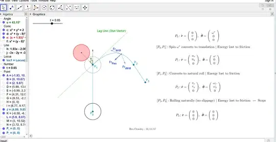

I am trying to calculate the total distance travelled by a pool ball in a shot modelled as shown in the picture. I intend to do a path integral once I've figured out the position vector of the ball at all times. For the moment I am assuming an infinite table so as to not worry about cushion interactions and also the initial spin is only top/back spin. I have tried to label as best I can what I think should be happening at each point and in each interval.
To keep things slightly simpler I have assumed a perfect collision with the red ball (cof elasticity = 1) so that I can make the stun vector 90° to the collision vector. Unless there is good reason not to I'm neglecting all interactions between the cloth and the ball other than friction.
I have reasoned that the overall friction will be a resultant of the friction caused by the translation of the ball combined with the friction caused by the relative slippage to due spin. - Is this correct?

$P_0-P_1 :$
With your chosen cartesian coordinate, consider the cue ball with radius $r$ start with initial velocity $\vec{v} = (0,v_0,0)$ and initial angular velocity $\dot{\theta} = (\omega^*,0,0)$ (so its back-spin). I assume we know the distance from $P_0$ to $P_1$ before its hit another ball. Call the distance $s$. Because its spin backward, the friction force must act on the ball to the negative direction of its velocity so the total force will be $\vec{F} = (0,-f,N-mg)$, where $f$ is its kinetic friction with magnitude $f=\mu_kN$. By Newton's law in the $y-$axis and torque equation $$ -f = m a_y \quad \text{and} \quad -fr = I \alpha $$ At this situation $a_y \neq \alpha r$ because its slipping. With distance $s$ the final velocity will be $$ v^2 = v_0^2 +2a_y s = v_o^2 -2\frac{f}{m}s = v_0^2 - 2\mu_kgs, \quad v = \sqrt{v_0^2 - 2\mu_kgs} \qquad (1) $$ To compute the final angular velocity we need the time travel of the ball with distance $s$, that is $$ s = v_ot + \frac{1}{2} a_y t^2 = v_0t - \frac{1}{2}\mu_kg t^2 \iff \frac{1}{2}\mu_kg t^2 -v_0t + s = 0 $$ and solve for $t$. The angular velocity will be $$ \omega = \omega^* + \alpha t = \omega^*- \frac{fr}{I} t = \omega^* - \frac{\mu_k mgr}{I} t \qquad (2) $$ So at $P_1$ the velocity is $\vec{v} = (0,v,0)$ and $\dot{\theta} = (\omega,0,0)$ and it still slipping (otherwise the ball will not move back after hit the another ball as shown by the video).

$P_1 - P_2$ (after collision) :
We have to analize two ball after the collision. Lets consider the easier first that is the target ball. Right after the collision, the target ball moving with velocity $V$ in the direction of the line perpedicular to the tag line. Call this line as $y'-$axis and the tag line $x'-$axis. Because of this, the target ball must slip for a moment and we have to find when this slip is over. By Newton's Law and torque eq. (along $y'$-axis) and the fact that $f = \mu_kMg$ $$ -f =-\mu_k Mg= Ma, \qquad -fr=-\mu_kMg r=I_M \alpha $$ So the velocity and the angular velocity of this target ball will be $$ V_M = V + at = V-\mu_k g t, \quad \omega_M = \omega_M0 + \alpha t = 0 - \frac{\mu_kMgr}{I_M} t $$ The minus sign in the $\omega_M$ just means that the roatation is top spin. The non-slip condition happen (at some time $t^*$) if the magnitude of $V_M$ and $\omega_M r$ are equall. So set $|V_M| = |\omega_M|r$ $$ V - \mu_k g t^* = \frac{\mu_kMgr}{I_M} t^* \implies t^* = \frac{V}{\mu_k g(1+ \frac{rM}{I_M})} $$ Put this back to the $V_M = V + at^* = V-\mu_k g t^*$ we have the final velocity of the target ball until non-slip condition $$ V_M = \frac{V}{\frac{I_M}{Mr}+1} $$ And we're done with the target ball.
For the cue ball after collision, the cue ball has condition $\vec{v'} = (v_x',v_y',0)$ with back spin $\dot{\theta}= (\omega,0,0)$ as before collision. Because of the back spin, there is a friction force $\vec{f_1} = (0,-f_1,0)$ and because of the movement in the $+x$-direction (by $v_x'$) we have the second friction force $\vec{f_2}= (-f_2,0,0)$ with their resultant $\vec{f}=\vec{f_1}+\vec{f_2}$ satisfy $|\vec{f}| = \mu_kmg$. And to this point i simply have a doubt about how to proceed to analized this. I'll update it another time if i know.
