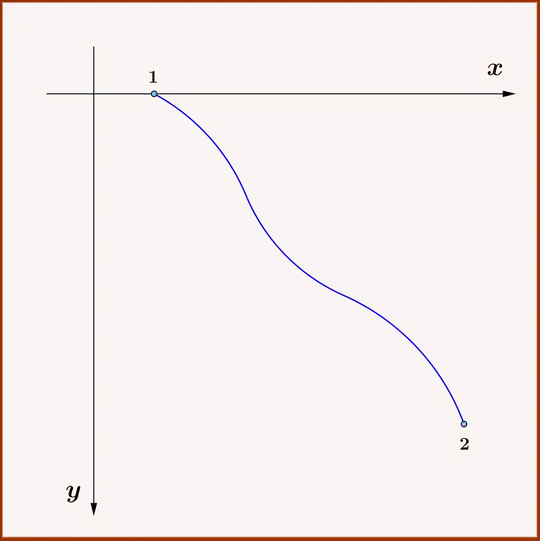

This well-known problem is to find the curve joining two points, along which a particle falling from rest under the influence of gravity travels from the higher to the lower point in the least time.
It's supposed that the motion on the curve is frictionless.
The time to travel from point 1 to point 2 is \begin{equation} t_{12}\boldsymbol{=}\int\limits_{1}^{2}\mathrm{d}t\boldsymbol{=}\int\limits_{1}^{2} \dfrac{\mathrm{d}s}{v} \tag{01}\label{01} \end{equation} where $\:s\:$ the arc-length parameter and $\:v\:$ the speed \begin{equation} \mathrm{d}s\boldsymbol{=}\sqrt{\mathrm{d}x^{2}\boldsymbol{+}\mathrm{d}y^{2}}\boldsymbol{=}\sqrt{1+y'^{\,2}}\:\mathrm{d}x \tag{02}\label{02} \end{equation} In equation \eqref{02} \begin{equation} y'\boldsymbol{\equiv}\dfrac{\mathrm{d}y}{\mathrm{d}x} \tag{03}\label{03} \end{equation} while from energy conservation \begin{equation} v\boldsymbol{=}\sqrt{2gy} \tag{04}\label{04} \end{equation} So \begin{equation} t_{12}\boldsymbol{=}\dfrac{1}{\sqrt{2g}}\int\limits_{1}^{2}\sqrt{\dfrac{1\boldsymbol{+}y'^{\,2}}{y}}\,\mathrm{d}x \tag{05}\label{05} \end{equation} Least time means \begin{equation} \sqrt{2g}\;t_{12}\boldsymbol{=}\int\limits_{1}^{2}L\left(y,y',x\right)\mathrm{d}x\boldsymbol{=}\text{extremum} \tag{06}\label{06} \end{equation} where \begin{equation} L\left(y,y',x\right) \boldsymbol{\equiv} \sqrt{\dfrac{1\boldsymbol{+}y'^{\,2}}{y}}\boldsymbol{=}\left(\dfrac{1\boldsymbol{+}y'^{\,2}}{y}\right)^{\frac{1}{2}} \tag{07}\label{07} \end{equation} is the Lagrangian of the problem.
The Euler-Lagrange equation \begin{equation} \dfrac{\mathrm{d}}{\mathrm{d}x}\left(\dfrac{\partial L}{\partial y'}\right)\boldsymbol{-}\dfrac{\partial L}{\partial y}\boldsymbol{=}0 \tag{08}\label{08} \end{equation} gives after lengthy differentiation or using the Beltrami Identity the following differential equation for the curve
\begin{equation} y'^{\,2}\boldsymbol{+}2y y''\boldsymbol{+}1\boldsymbol{=}0 \tag{09}\label{09} \end{equation}
