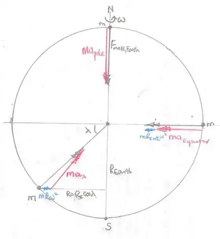

Assuming a spherical Earth you are quite right that the force on a mass due to the gravitational attraction of the Earth $F_{\rm mass,Earth}$is the same at both the Poles and along the Equator.
However when you drop an object at a Pole it only suffers and acceleration towrds the centre of the Earth so the equation of motion is $F_{\rm mass,Earth}= m a_{\rm Pole}$.
On the Equator the gravitational force accelerates the mass in two ways.
Towards the centre of the Earth $a_{\rm Equator}$ which is the free fall component and again towards the centre of the Earth $R_{\rm Earth} \omega^2$ (centripetal acceleration) which makes the mass go round in a circle of radius $R_{\rm Earth}$ which is the radius of the Earth.
Now the equation of motion is $F_{\rm mass,Earth}= m a_{\rm Equator}+ mR_{\rm Earth} \omega^2$ from which you can see that $a_{\rm Equator} < a_{\rm Pole}$.
This rotational component contributing to a difference between the acceleration free fall at the Poles and along the Equator of about $0.35\%$.
Note that at other places on the Earth the centripetal acceleration and the acceleration of free fall are no longer in the same direction and a body no longer free falls, $a_{\lambda}$, towards the centre of the Earth.
