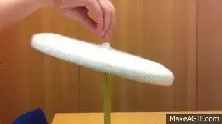

In the gif taken from here you can see an inclined disk rotating about the $\hat{z}$ axis. Our first goal is to find this disc moment of inertia. It is pretty clear that in the principal axes coordinates this tensor takes the form

where I assumed for simplicity that $\theta=45^{\circ}$. Now if you rotate this body around the $\hat{z}$ axis with $\vec{\omega}^{\prime}=\omega\hat{z}$, you get
$$\vec{L}^{\prime}=\hat{I}^{\prime}\omega^{\prime}=\begin{pmatrix}0\\ \frac{I_1-I_0}{2}\\ \frac{I_1+I_0}{2}\end{pmatrix}\omega$$
You can see that the off-diagonal elements are merely the result of choosing this particular coordinate system. This means that you actually rotate your body in two different axes. You could, in principle, use $\hat{I}$ and rotate $\omega$ to get $$\vec{L}=\begin{pmatrix}I_{0}&0&0\\0&I_{0}&0\\0&0&I_{1}\end{pmatrix}\begin{pmatrix}0\\ -\frac{\omega}{\sqrt{2}}\\ \frac{\omega}{\sqrt{2}}\end{pmatrix}=\begin{pmatrix}0\\ -\frac{I_0}{\sqrt{2}}\\ \frac{I_1}{\sqrt{2}}\end{pmatrix}\omega$$
which is the same as before, written in the unprimed coordinates.
