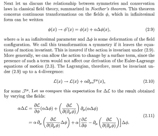

I have a question concerning the derivation of Noether's theorem in Peskin & Schroeders introduction to QFT. Below is a picture of the first part of it.
The proof then proceeds by saying that one term vanishes because of the euler-lagrange equations. It seems to me like what they are saying is that the term only vanishes because we have a symmetry transformation. But to me this is the general behaviour of the lagrangian under a transformation and the term in the brackets will always vanish, regardless of the transformation. So my question is: Why does the term in the square brackets in eq. (2.11) only vanish for symmetry transformations?

The writing is certainly less clear than it ought to be. Your instincts are right; they just didn't explain it well. In particular, they're not saying that the term in brackets only vanishes for symmetry transformations. It always vanishes for a field obeying the Euler-Lagrange equations.
What they're really saying is:
  1. A continuous transformation can be written as equation (2.9)
  2. The equation of motion will be invariant under that continuous transformation if the Lagrangian changes as equation (2.10)
  3. Let's see how the Lagrangian actually changes under the transformation of (2.9)
  4. It changes as a term that looks like $\alpha \partial_\mu \mathcal{J}^\mu$ plus a term that goes to zero because of the Euler-Lagrange equations for the original, un-transformed system
  5. The actual change we get is the change we demanded for the Lagrangian to be invariant up to a 4-divergence
  6. Therefore, the continuous transformation is a symmetry transformation
The text immediately following what the OP included says
The second term [in equation (2.11)] vanishes by the Euler-Lagrange equation. We set the remaining term equal to $\alpha \partial_\mu \mathcal{J}^\mu$ and find \begin{equation} \partial_\mu j^\mu(x) = 0\, \qquad \mathrm{for} \qquad j^\mu(x) = \frac{\partial \mathcal{L}} {\partial (\partial_\mu \phi)} \Delta \phi - \mathcal{J}^\mu. \end{equation}
This really makes it look like they're saying that $j^\mu$ is identically zero; in fact, I would argue that that's the most reasonable reading of the text. What they should have said is that we get the generic result \begin{equation} \Delta \mathcal{L} = \partial_\mu \left( \frac{\partial \mathcal{L}} {\partial (\partial_\mu \phi)} \Delta \phi \right) \tag{A} \end{equation} whenever $\phi$ satisfies the Euler-Lagrange equations, but to call $\Delta \phi$ a symmetry transformation we require the existence of some other field $\mathcal{J}^\mu$ such that \begin{equation} \Delta \mathcal{L} = \partial_\mu \mathcal{J}^\mu \tag{B} \end{equation} regardless of whether or not the Euler-Lagrange equations are satisfied. Again, (A) is generically true for any differentiable Lagrangian and field satisfying the E-L equations. On the other hand, you have to use the particular form of $\mathcal{L}$ and the particular form of $\Delta \phi$ to decide if (B) is true in any particular case. (Also note that $\mathcal{J}^\mu = 0$ is perfectly acceptable.)
