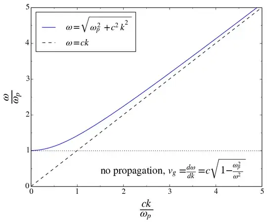

  3. For $\omega>\omega_p$, the electrons are unable to completely cancel the electric field of the EM wave, so the wave is able to propagate in the plasma (see figure below). The collective electron motion is still able to cancel some of the electric field within one period of oscillation of the wave and establish a reflected radiation field as well.

Plot of the dispersion relation for EM waves in a plasma: Dispersion relation for EM waves in unmagnetized plasmas
