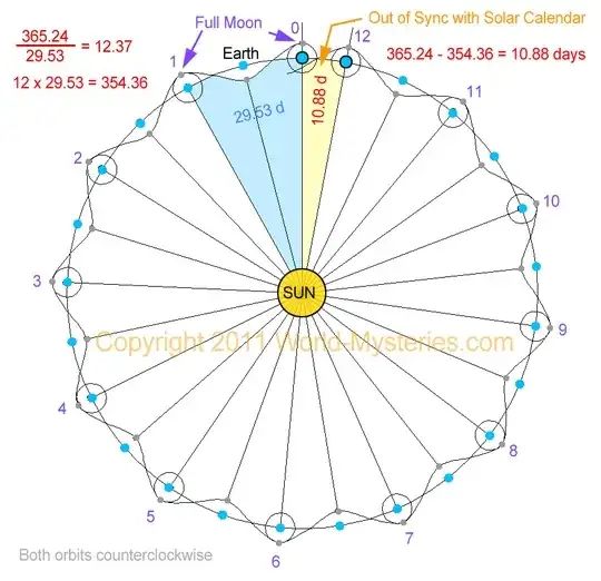

That small velocity of the Moon relative to the Earth is not enough to make much of dent in the overall velocity of the Earth-Moon system about the Sun. So the Moon is orbiting the Sun and moving around the Earth as well in a kind of wiggly path that's nearly, but not quite an ellipse.
Now the Earth also has it's motion about the sun altered by the Moon and it also describes a path that's a little wiggly, but it's not as obvious because it's bigger and wiggles less.
There is a nice diagram in this blog post on the subject showing an exaggerated the way the Moon actually orbits the Sun. I'll link to it here :
