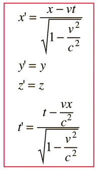

The statements set is derived and stated by using the mathematics of the mathematical level. (the way a word is written by using the alphabet) In the mathematical level itself there exist singularities. In the link for Lorentz transformations one observes that when the velocity of a particle is c an infinity appears:
lorentz
Statement A: " Speed of light is same wrt to A reference frame" Statement B: " Speed of light is same wrt to B reference frame" Statement C: " Speed of light is same wrt to it's own reference frame".
So your statement C does not belong to the set of statements derivable from the mathematics, because an infinity appears and C is undefined, so cannot have a reference frame. (that is the origin of the statement) You derive it from statements A and B by logic , mixing a higher level with a mathematical under-level. Logic is not enough to do the mathematics of Lorenz transformations.
