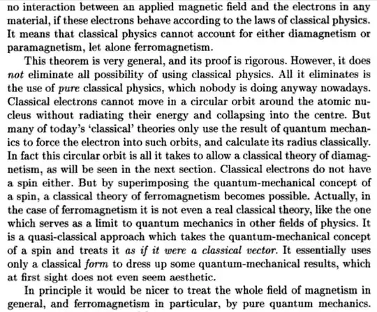

I have found the following interesting answer to the question, from "Introduction to the Theory of Ferromagnetism, Amikam Aharoni".
