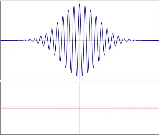

As you point out, self-phase modulation can be thought of as an added chirp, but the crucial point is that this is a local chirp that changes from the front to the back of the pulse, in essence because the phase velocity in the middle of the pulse is faster than at the edges, because of the changed refractive index at its higher intensity, and this compresses and decompresses the wavefronts in the leading and trailing edge of the pulse:
This introduces local frequencies that were simply not present within the original pulse spectrum, leading to a spectral broadening. (The pulse's electric field is in blue, instantaneous frequency is in red.)
