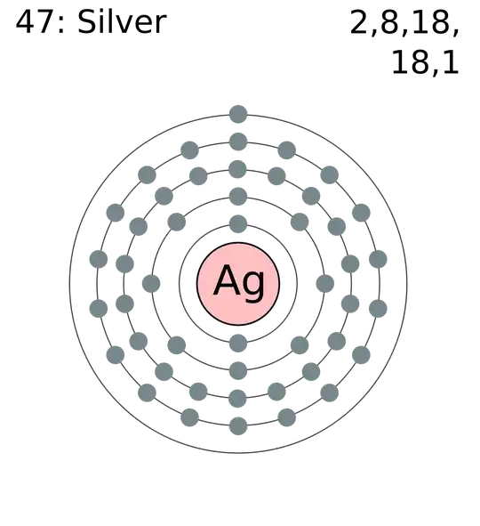

Let's take a look at silver: enter image description here
You can see that silver has 5 electron shells, with 46 (18+18+8+2) electrons shielding the valence electron. It has one electron in the valence, so it is a good conductor.

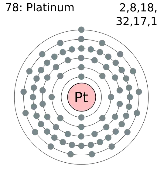

Now, let's look at platinum: enter image description here
Platinum, also, has a single valence electron. However, there are 6 electron shells -- one more than silver. There are 77 (17+32+18+8+2) electrons shielding the valence electron. Platinum has a larger radius than silver and, similarly, has a single valence electron.

The situation is a lot more complicated than you described. When calculating the conductance of a metal, you first need to evaluate the allowed energy states of electrons in the bulk material, which is done by placing nuclei in a regular pattern (depending on the crystal structure). Usually, various approximations are used, which may or may not include the interaction between the electrons. Then you count the number of states at a given energy and get the so-called density of states. Then you start putting the electrons into these allowed energy states, until all electrons belonging to that element are added. And only then will you know if something is a conductor at all. For insulators, there is an energy gap between the highest occupied and the lowest unoccupied state, i.e. there are no states just above the energy of the highest filled state (the so-called Fermi energy). For metals, there is not.
I'm aware that this might be hard to follow if you are not familiar with these terms, but it's just to show that from a single atom sketch you can not conclude the electronic properties of the bulk material.

It appears that none of the responses so far have addressed the real reason silver is a better conductor than platinum.
The reason is electron scattering. The simplest model for conductivity in solid state physics is called the Drude model. This is a microscopic description of what happens to the electrons when you apply an electric field to get them moving. The Drude model explains Ohm's law of resistance, among other things, and it works surprisingly well for all simple conductors (and some not-so-simple ones).
The basic assumption of the Drude model is that electrons scatter off of things as they move around in the material. They basically scatter off the crystal lattice ions and can generate lattice vibrations (heat). Each material has a characteristic scattering time determined by the details of the crystalline structure, the temperature, and other things. In metals, electrons scatter around once every $10^{-14}$ seconds (!).
Ultimately, electrons in platinum scatter more rapidly than those in silver (by a factor of two or so). According to the Drude model, this means platinum has a lower conductivity.
