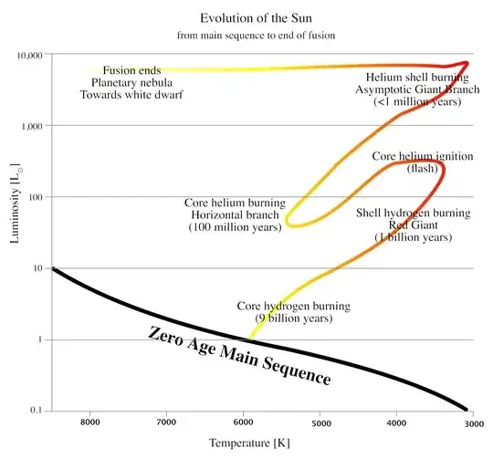

Wikipedia has a more detailed diagram for the evolution of the Sun, which also gives the temperature, which we need to compute the habitable zone.
I am going to use the model in [KRS+14], which is the same article quoted by @KyleOman. I will consider three milestones: the end of the main sequence, the end of the red giant just before the helium flash, the end of the horizontal branch.
  • end of MS: luminosity ⨉ 3, temperature 5500 K;
  • end of RG: luminosity ⨉ 300, temperature 3200 K;
  • end of HB: luminosity ⨉ 20, temperature 5000K.
