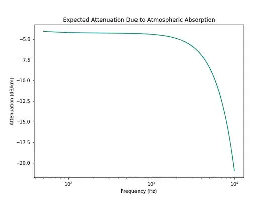

At long distances, molecules in the atmosphere (mainly diatomic Oxygen and Nitrogen) act as a sink of acoustic energy and thus filter acoustic signals. The effect is most pronounced at high frequencies.
Where I live a typical summer day is about 13° C and 70% relative humidity. A typical atmospheric pressure is 96 kPa. The effect with distance due to atmospheric absorption is as follows: atm absorption
(The code I used to make the calculations is here, in case you want to tweak things for your part of the globe. Otherwise you're going to have to take my word that the general shape of the curve doesn't change much with temp/RH/atmospheric pressure and my answer is generally applicable.)
In any case you can see that high frequencies are significantly influenced at distance.

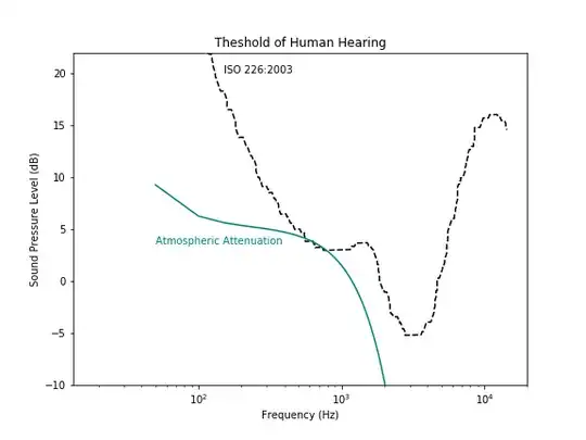

We can imagine a source of white noise that, by definition, has equal acoustic intensity at all frequencies. That's convenient because we can continue to scale the attenuation with atmospheric absorption until it becomes inaudible. That is, where it intersects the ISO 226:2003 equal loudness contour for the threshold of human hearing. where can you no longer hear
By this approach it would appear that at least for atmospheric conditions in my neck of the woods the last remaining audible frequency would be somewhere around 700 Hz.
Disclaimer: I'm not sure how often atmospheric absorption would be the limiting factor outdoors. More likely your source would be attenuated by terrain or ground effect well before you got far enough away for atmospheric attenuation to do the job. Additionally your sound source may be masked by other ambience before you could get far enough away for atmospheric attenuation to matter this much. Then the last frequency you would hear would depend entirely on the environment you were in.
