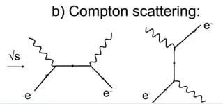

Photons and electrons are quantum mechanical entities. Acceleration means interaction of the electron with a field, getting a dp/dt . The simplest Feynman diagram showing such an interaction is Compton scattering :
Total absorption would mean an incoming photon+ electron , and outgoing only an electron. This cannot happen because the electron has a fixed mass and does not have excited states to absorb all the energy of the photon. What can happen is that most of the energy of the photon becomes kinetic energy of the electron, in any inertial frame, and correspondingly the photon can have very small energy , tending to zero but never zero.
If the outgoing (or incoming) photon becomes virtual, connecting with an electric or magnetic field, then the kinematics has to include the originator of the field in energy momentum considerations, and the electron can absorb all the energy of the incoming photon the energy/momentum balance in its rest mass system taken up by the generator of the field that gave the virtual photon.
