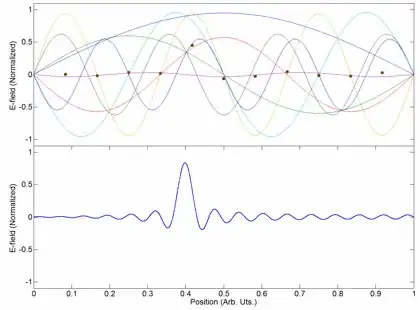

Thus light waves don't have to be sines or cosines, but also (infinite) sums of those. For example, some LASERs like Ti:Sapphirre use a technique known as Mode-Locking in order to achieve very short pulses of light. This is demonstrated in the figure below taken from wikipedia article on mode locking. In the lower part of the figure you see the actual pulse of light emitted by the LASER. In the upper part you see its decomposition into sine and cosine modes. In other words, if you sum the functions in the upper part, you'll get the pulse in the lower part.
Mode Locked Pulse
