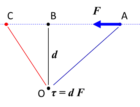

Consider first a force $F$ on a point A, and the torque it produces about the origin O
fig1
The magnitude of the torque equals to $|\tau| = d\, |F|$ where $d$ is the minimum distance to the line.
Now consider sliding the force over to points B (or C). The magnitude of the torque remains the same because you have not changed the line of action of the force.
A forced line of action is defined by the direction of the force vector, and the point the force goes through.
By sliding the force vector along its line of action, you are not changing the nature of the problem. The corollary to this by defining the torque $\tau$ about the origin you essentially define what the minimum distance $d$ is for a force $F$.
