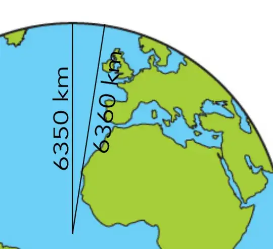

A plane travels at an altitude of about 8-10 km. The earth's radius is 6350 km - so you may reach a maximum distance of 6360 km from the center of the earth. Here's what that relative change looks like:
Tangential velocity is $ v_T = \omega r$
At the surface of the earth:
$$ v_{surface} = \omega \cdot 6350 $$
At cruising altitude
$$ v_{flight} = \omega \cdot 6360$$
So the difference in tangential velocity $$ 1 - \left | \frac{6360}{6350} \right | \approx 0.15\%$$
The maximum tangential velocity of the earth is around 1500km near the equator - so the largest difference would be on the order of 2-3 km/h.
