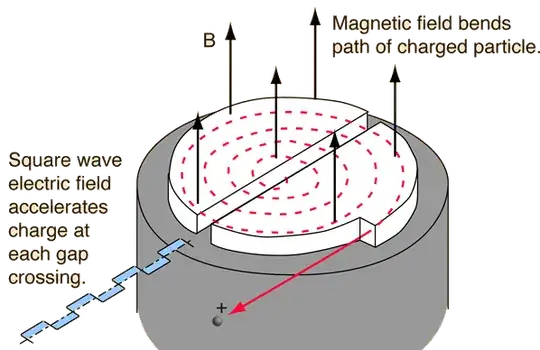

(A) This should be answered "yes" by this graph from hyperphysics on the cyclotron, which is for positively charged particles though:
Indeed, the electron(s), when looking in the direction of the field, orbit(s) clockwise.

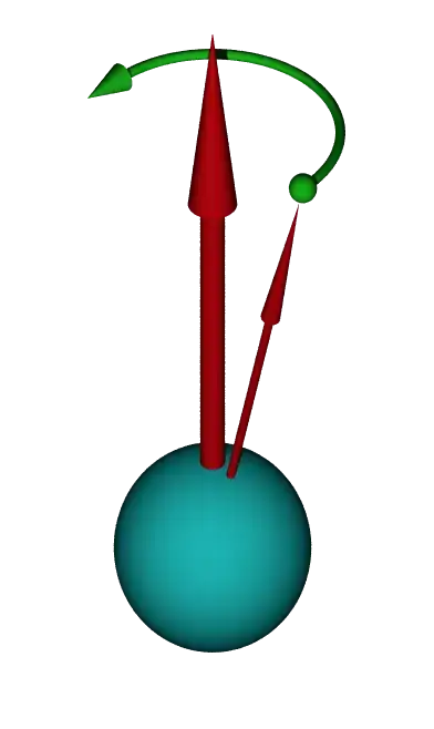

(B) The question on precession for negatively charged particles should be answered "yes" by this picture from wikipedia, where the large red arrow is the magnetic field:
The sense of precession is the same as the sense of rotation.
