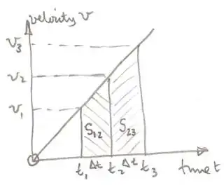

Since the force $F$ is constant the velocity against time graph for your object will be a straight line.
Let the velocity at times $t_1,\,t_2\, t_3$ be $v_1,\,v_2\, v_3$ and $t_3-t_2 = t_2-t_1 = \Delta t$
Since the acceleration is constant then in equal increments of time the increase in velocity is the same $v_3-v_2=v_2-v_1$.
The distance travelled by the object in these equal increments in time is the area under a velocity time graph $s_{12}$ and $s_{23}$.
So the work done by the force in these increments of time is $F\,s_{12}$ and $F \, s_{23}$ and this is equal to the change in kinetic energy of the object in these intervals of time.
Since $s_{12} <s_{23}$ the increase in kinetic energy will be greater the higher the velocity of the object.
So it all boils down to the fact that in a given time $\Delta t$ the impulse on the object $F\Delta t$ changes the velocity of the object by the same amount but the work done by the external force, which is equal to the change in the kinetic energy of the object, is larger in the second interval of time than the first interval of time because in that second interval of time the object has travelled further.
