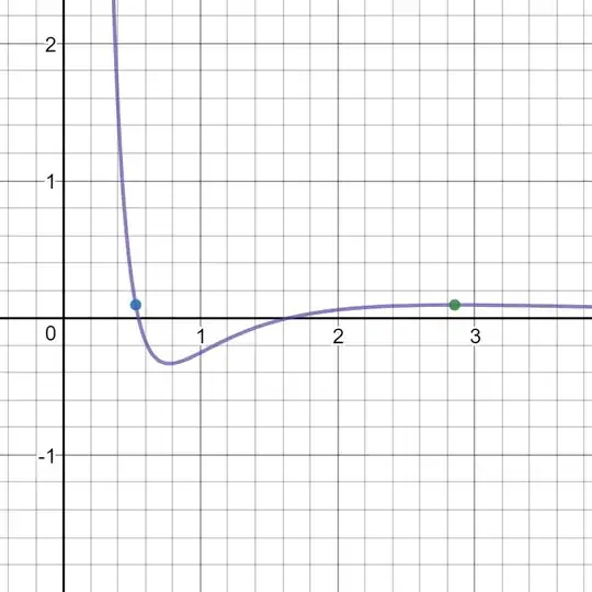

I've also graphed the corresponding energy diagram, and I get something that I'm not quite sure how to interpret. Essentially, there seems to be a certain tuning of the parameters where there can be a bound elliptical orbit with $E \gt 0$. I was under the impression that a bound orbit requires negative energy (in the sense that we define zero energy to be at infinity). Am I missing something here?
Update: I think my question about closing orbits is mostly answered. I was just wondering if something about my energy diagram could point to the fact that a certain elliptical orbit could precess. In particular, I've added two points on my graph that shows an initial given energy, which is positive. If I understand the diagram correctly, the particle should oscillate between the radii of these two points on the graph. However, unlike with regular $1/r$ potentials, these orbits seem to be bound, yet still have positive energy. Is this allowed? I was under the impression that the energy needs to be negative in order to stay bound, but it seems like it's possible to have a positive energy and still have a bound elliptical orbit.
Yukawa potential energy with centrifugal contribution

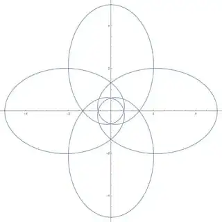

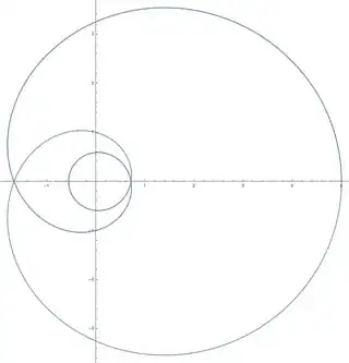

For instance, using $r_0=1$, the first two figures below show closed orbits, with $(e,\beta)=(\frac{4}{5},\frac{4}{5})$ and $(\frac{4}{5},\frac{1}{3})$ respectively.

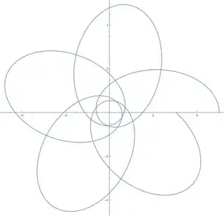

The figure below shows an orbit that is not closed, with $(e,\beta)=(\frac{4}{5},\frac{2+\pi}{2\pi})$.

The energy diagram will guarantee that you have bounded motion, but not necessarily closed orbits.
