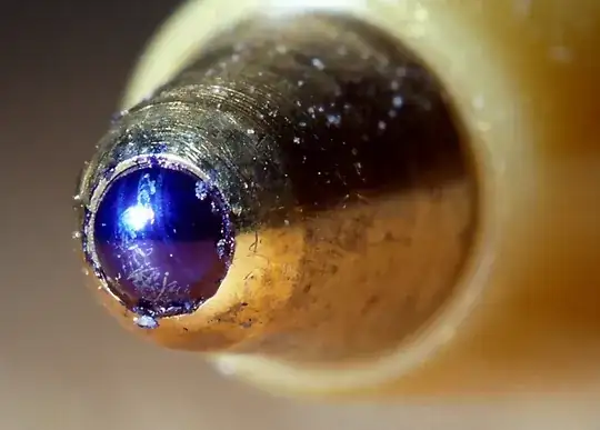

This deformation creates the little indents on the page (and on pages below it; you can often see on the next page the indents for the words you wrote on the page above). The deeper these indents are, the more of the ballpoint is able to make contact with the surface.
Ballpoint pen tip up close
If there is barely any deformation, then the flat surface doesn't get to make good contact with the page. This makes it hard for the tip of the pen to actually roll, which is what moves the ink from the cartridge to the tip. It would also make a thinner line due to less contact area.

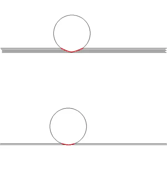

Here is an amazing exaggerated illustration I made on Microsoft Paint:
Pens on page in paint
The top one has more pages, the bottom one has fewer. I've exaggerated how much the pages deform obviously; but the idea is that having more pages below with make that indent larger; leading to the increased surface area on the pen tip.
