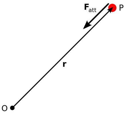

In the above picture, the distance of the body at P from O is $r$. As the force $F_{att} $ acts along the line joining the body and the origin, that is the position vector, the force is a central force.
