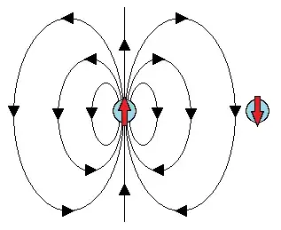

If we consider two dipoles, they should have the lowest energy when the dipoles are pointing in opposite directions, so that each dipole is aligned with the field of the other: dipoles aligned with field

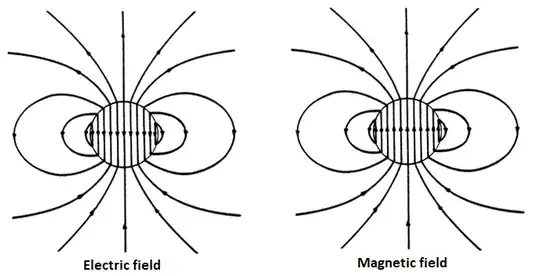

Since we need to integrate over all space, we cannot neglect the field inside the spheres. This actually turns out to be important, and is where the electric and magnetic dipoles differ. The electric field lines switch directions in the polarized sphere, while the magnetic field lines do not.
$$\mathbf{E}_\text{dipole} = \begin{cases} \frac{1}{4\pi\epsilon_0 r^3} ( 3(\mathbf{p}\cdot\mathbf{\hat{r}})\mathbf{\hat{r}} - \mathbf{p}) &, r > R \\ -\frac{1}{3\epsilon_0}\frac{\mathbf{p}}{\frac{4}{3}\pi R^3} = -\frac{1}{3\epsilon_0} \mathbf{P} &, r < R \end{cases} \tag{3}$$
$$\mathbf{B}_\text{dipole} = \begin{cases} \frac{\mu_0}{4\pi r^3} ( 3(\mathbf{m}\cdot\mathbf{\hat{r}})\mathbf{\hat{r}} - \mathbf{m}) &, r > R \\ +\frac{2\mu_0}{3}\frac{\mathbf{m}}{\frac{4}{3}\pi R^3} = +\frac{2\mu_0}{3}\mathbf{M} &, r < R \end{cases} \tag{4}$$
