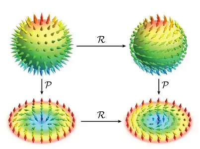

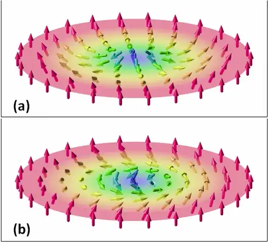

Naively there are non-chiral skyrmion [Fig (a)] v.s. Left/Right chiral skyrmion [Fig (b), shown the Right chiral skyrmion].
However, under the rotation $R$ about the $z$-axis and the stereographic projection $P$, the non-chiral skyrmion and Left/Right chiral skyrmion can be transformed into each other. In other words, we can also see the topological index $n= {\tfrac{1}{4\pi}}\int\mathbf{M}\cdot\left(\frac{\partial \mathbf{M}}{\partial x}\times\frac{\partial \mathbf{M}}{\partial y}\right)dx dy$ for non-chiral skyrmion and Left/Right chiral skyrmion can be the same!

The Skyrmion chirality is not topological. Left and right Skyrmions carry the same topological charge. For a particular magnet, left and right Skyrmions are separated by an energy barrier and only one of them is the minimum energy solution. The Barrier is due to the Dzyaloshinsky-Moriya term: $$\int d^2x D \hat{M}\cdot(\nabla \times\hat{M})$$ This term exists in magnets with broken spatial reversal symmetry. Rotating the Skyrmion about the $z$-axis by an arbitrary angle $\theta$ $$\hat{M}' = (M_x \cos\theta + M_y \sin\theta , -M_x \sin\theta + M_y \cos\theta , M_z)$$ does not change the topological charge, nor the leading terms in its energy functional ,such as $J (\nabla \hat{M})^2$. However, the Dzyaloshinsky-Moriya term is linear in $\sin \theta$, thus the minimum energy is obtained at $\theta = -\frac{\pi}{2}$ when the coefficient $D$ is positive and $\theta = \frac{\pi}{2}$, when it is negative. The sign depends on the sign of the spin orbit interaction of the underlying microscopic theory.
It is possible in principle to reverse a Skyrmion chirality by controlling the parameter $D$ of the Dzyaloshinsky-Moriya term.
The Skyrmion chirality cannot be associated to a topological charge, because the transformation between a left and a right handed Skyrmion is smooth. In addition, the first homotopy group $ \pi_1(S^2) = 0$ of the $2$-sphere vanishes (the sphere has no one dimensional holes), thus the chirality cannot be expressed as a one dimensional winding like the case of a vortex.
