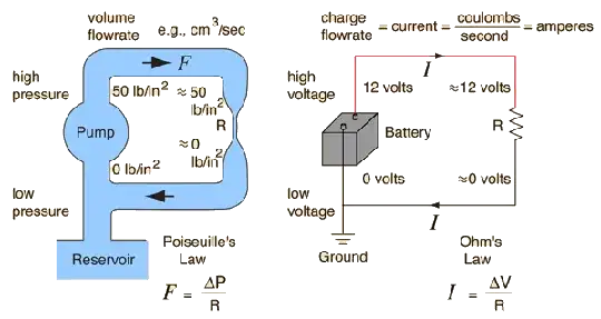

Maybe this link will clear it up for you, an analogy with water circuits.
groundreserv
The reservoir provides a pressure reference, but is not part of the functional circuit. Likewise, the battery can circulate electric current without the ground wire. The ground provides a reference voltage for the circuit, but if it were broken, there would be no obvious change in the functioning of the circuit. The ground wire protects against electric shock and in many cases provides shielding from outside electrical interference.

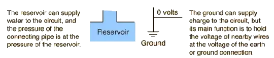

Also this :
circuit reservoir
It is all a matter of energy carriers in both the water and the electrical circuit. In water it is molecules, once the water circuit has enough water the reservoir is needed only for leaks. It is the pump that supplies the energy to the flow of water. The electric circuit is full of electrons, it is the battery that supplies the energy for the motion of electrons so as to generated a current, which uses the ground as a reference 0 energy difference level (thus no current going through).
but it isn't going back to source of the circuit.But then I also heard that a circuit needs to be completed in order for an electric current to flow. But in the case of the earth wire, the current is just going into the ground
In stable conditions there is no energy going to the ground. Only if by accident instead of 0 volts a voltage appears at the input to the ground wire there will be a current and the circuit will close to the ground by discharging all electrons to the great reservoir of electrons in the ground. There will be a short, and the original circuit no longer works.
