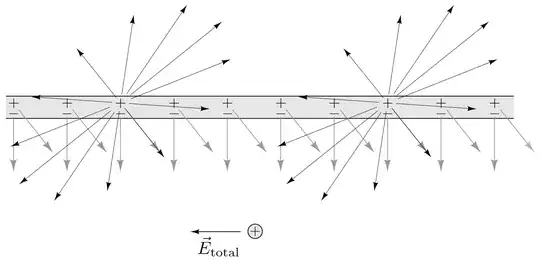

Explanation Using Electric Fields and Relativity
We can also do away with magnetic fields and explain this effect purely through electric fields and special relativity: In the reference frame of the charged particle, we can note that the positive charges are moving diagonally down and to the right, causing them and their electric fields to be Lorentz contracted in that same direction. As you can see in the image below, this means that the electric forces repelling the particle from the right are stronger than those repelling it from the left, resulting in a net force that pushes it to the left. Note that since the negative charges are just moving straight down, they exert no net horizontal force on the particle.
Charged Particle Moving Toward Wire
In terms of net vertical force, since the vertical components of the velocities of the positive charges are equal to those of the negative charges, the same is true of their contraction and thus of their E fields. This combined with the fact that the positive and negative charges are equally numerous means that the vertical components of their E fields cancel out, leaving the force to the left as the only net force on the particle.
