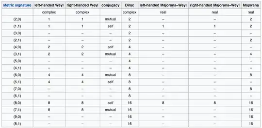

Question: How do we match the real degrees of freedom (DOF) of Dirac/Majorana/Weyl Spinor in terms of their quantum numbers (spin, momentum, etc) in any dimensions [1+1 to 9+1] in Minkowski signature?
(p.s. This question is partially inspired by this one, but I am asking something more generally in any dimensions from 1+1 to 9+1 in Minkowski signature)
My question concerns that how to match each component of spinors in physical degrees of freedom (real degrees of freedom of Dirac/Majorana/Weyl Spinor) reflecting into their quantum numbers.

How about other dimensions?
There will be certainly an even-odd dimensions subtlty. Also the the helicity like degrees of freedom (the spin projected along the boost direction) may NOT be enough for other dimensions higher than 3+1d.
