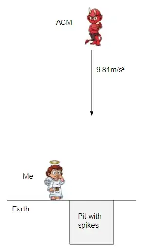

Since a stray string theorist has wandered into the hallowed halls of general relativity I'd like to expand on my answer to talk a bit about what is going on. Suppose ACuriousMind is the one falling towards the Earth and I am the one stationary on the surface. And suppose someone has sneaked up behind us and blindfolded us both so we can't see what's happening. How do we know which of us is falling and which is standing on the Earth's surface?
Gravity
The answer is simply that ACM feels himself to be weightless while I feel my weight i.e. I feel the surface of the Earth pushing me upwards. So even though neither of us can see a thing we both know where we are.
But now suppose someone sneakily removes the earth and places a rocket motor under my feet that accelerates upwards at $9.81$ m/s$^2$. Since there's no Earth there is no gravity so ACM is just happily floating weightless in space. But I feel an acceleration pushing me up just like the Earth's gravity. Both of us are blindfolded remember, so as far we as know nothing has changed and the situation is exactly the same as it was before.
Non-inertial frame
But of course now there is no gravity. Now I am in a non-inertial frame, while you are in an inertial frame, and this is the point made in ACuriousMind's answer. You are accelerating towards me because I am accelerating towards you. So you can be accelerating towards me even though you are weightless.
So why did I jump straight to general relativity? Well let's put the Earth back, and now suppose my brother Albert has dug a deep tunnel right to the centre of the Earth and is hovering there. He is hovering because the gravity at the centre of the Earth because the gravity falls to zero at the centre of the Earth. And since I am stationary on the surface and Albert is stationary at the centre we are stationary with respect to each other. That means ACM is accelerating (as he falls) towards both me and Albert at the same rate.
But, Albert is weightless while I'm not. Unlike before we can't snatch the Earth away and reproduce the situation with rocket motors. For both Albert and ACM to be weightless they cannot be accelerating towards each other.
And this is the key point. We can always reproduce the effect of gravity using Newtonian mechanics and non-inertial frames, but we can only do it locally. That is we can do it for selected pairs of observers but not for all observers. And this is where general relativity comes in.
