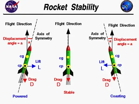

More fundamental than the gimballed thrust system or verniers is the relationship between the "center of gravity" and "center of pressure" on a rocket (or any kind of projectile (e.g., bullet).
For the rocket to fly nose-forward and not flip around, the center of gravity must be ahead of the center of pressure. In building small amateur or model rockets, the guideline is always that the CG should be at least 1 body diameter ahead of the CP.
The center of gravity is the point where the mass components of the rocket "act" with respect to the ground (i.e., you can treat the CG as a point representing "the rocket" when calculating the opposing force of gravity pulling the rocket downward). The center of pressure is the point where aerodynamic forces on the rocket body, nose, and any fins sum together and "act".
rocket stability
In the above answer about gimballed thrust, for example, the gimbals are actually acting to force the CP back under the CG when the nose tilts. Fins (e.g., on missiles or model rockets) act in the same way to keep the CP under the CG.
So individual technologies for doing that may vary, but the underlying principle here is the CG/CP relationship. Hope that helps.
