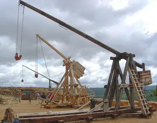

I misspoke when I said catapult, a string tension driven device. I meant a trebuchet, a gravity-powered heavy-object thrower. QuickLaunch, Inc. has plans to do just this launching a SSTO rocket at 6 km/s, which then fires after launch and provides the necessary correction for orbital insertion. Basically, I just need a trebuchet that will accelerate a mass (they're trying 1kg, 10kg, 50kg and 500kg masses) to 6 km/s at launch.
Trebuchet
