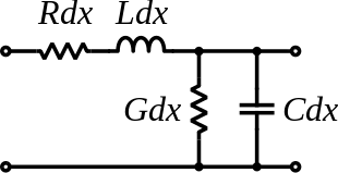

A transmission line can be modeled as a "ladder" of resistive and inductive elements with capacitors to the other conductor. (Image from the linked wikipedia article). This is one "block" of a transmission line. A real transmission line can be modeled by repeating this, and taking the limit as the number goes to infinity while the resistance / inductance / capacitance goes to zero. (You can usually ignore Gdx, the resistance of the insulator separating the conductors.)
telegrapher's equations
This model of a transmission line is called the telegrapher's equations. It assumes the transmission line is uniform over its length. Different frequencies in the same wire "see" different $R$ and $L$ values, mainly due to the skin effect (higher resistance at higher frequency) and proximity effect. This is unfortunate for us, because an impulse from flipping a switch is effectively a square wave, which in theory has components at infinitely high frequencies.
Wikipedia's transmission line article derives this equation for the phase shift of an AC signal in a transmission line of length $x$. (They point out that an advance in phase by $-\omega \delta$ is equivalent to a time delay by $\delta$.)
$V_out(x,t) \approx V_in(t - \sqrt{LC} x) e^{-1/2 \sqrt{LC} (R/L + G/C) x}$
